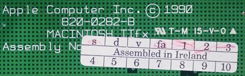

I recently purchased a stealth Macintosh IIfx revision B. That is, one of the original owners had a Macintosh II that they upgraded the motherboard to a IIfx.
The board looked clean and there wasn't any battery damage. I figured this would start right up after recapping. But, it ended up being one of the longest repair jobs I have ever done.

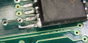

UD13 had a broken pad. It might have completely broken during cleaning -- but nevertheless it was bad. I cleaned and replaced UE13 and UD13 at the same time. (Insert first mistake here).
I removed and replaced UM7, which had had the broken ground pin from earlier. However, upon cleaning the pads, they just disintegrated.
I removed the solder mask from the vias on the opposite side of the board. I hand drilled (finger touch) the holes and blew them clear with compressed air. I installed 30 AWG tinned buss wire through all of the holes. And soldered them from below. The photo below is on the bottom side of the board before soldering. I did all eight pins because I couldn't trust even the good looking ones.
I soldered the tops of the wires to the replacement chip. I know this looks awful, but it has solid connectivity and is without shorts.

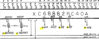

I pulled the FPU and CPU and proceeded to tone out every single pin. The 68030 pinout and 68882 pinout figures available online and in the datasheets are all bottom view. it is much easier to tone out a board from the top. Here are my swapped top view images, which may help you tone out your boards.
The 68030 socket toned-out perfectly. The 68882 socket toned out for many, but not all pins. It turns out that the pins on the schematic that start with 'X-' and 'B-' do not go directly to the CPU. These are buffered through other chips. After I realized this, I was successfully able to determine that none of the traces going to the FPU socket were faulty.

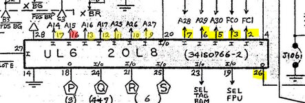

Consulting the Motorola 68030 user's manual, this is how the FPU gets selected. (Aside: when checking continuity, notice below that AO and SIZE are tied to VCC and not connected to the CPU).
Okay. What is the FPU chip select decoder on the IIfx? It's UL6. My chip looks clean. But, let's tone it out. Uh oh. On the second to the last pin I checked, A15 (pin 16) is not connected. Thus, the FPU is not being enabled as requested.
And how does A15 get there? I don't know -- but it isn't on a surface layer. That's right. I have a break somewhere inside the board. In fact, I'll bet A15 connects to one of the corroded vias in that set of 74F245s that I fixed in the very beginning. (Photo below is after the repair.)
Putting a wire through the via for A15 and then connecting a bodge wire to the via where A15 comes up for UL6 did the trick. This Macintosh IIfx is fully functioning again!
