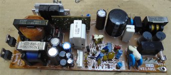

not sure what "massa" is. that would sort of label what it is. But from a quick eyeball, its a +12V regulator.
Now I am thinking it something else, it has +12V, a GND, but it also has +5v going into it. That is very strange for a regulator.
I dont have a TDK supply handy to figure it out so thats about as far as I can go.
Yes is strange... the circiut already have 2 rectifier diodes (on the heatsink) this psu need three diodes? Or is a thyristor?

The more a stare at it, the more it looks like a dual diode. maybe a clamping network.
I agree. That PS is similar to the Sony PS in my HD20 SC I recently worked on.
Here's an image of the corresponding components in the Sony PS. Also apparently unmarked.

The others two diodes is c82m and is marked on pcb as CR51 CR52, the lost component is IC55 (CR is used for the diodes on this pcb)
