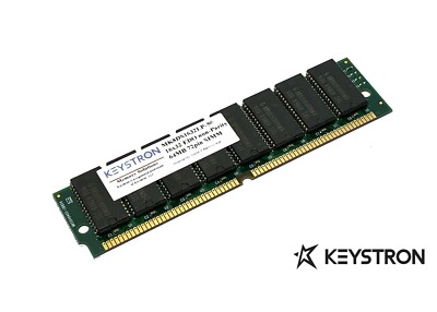

Are you able to tell more details about the SIMM you used?
- Number of chips
- Exact type of chips

Chips in the EBay offer are KM44V16104BK-5: 50ns, 4k Refresh 3,6V maximum Supply Voltage.
No Voltage regulator visible on front side.
The chips in your Macintosh are different but not readable from the photo (Samsung K4E6... I guess)
Do you like to tell what chips you got?
