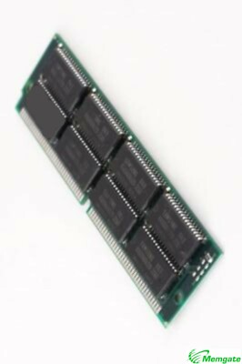

SIMM are either 5V or 3,3V. You need to know the exact typ of the chips to determine and read datasheet.
In this offer the type is not readable, so you have to ask the seller.
Some seller tell that 3,3V SIMM will work in 5V computer (as the 475) as well. Usually this is out of specification.
There are a few SIMM that have 3,3V chips and voltage regulator on board (but they don't work at 3,3V anymore)
So I would not trust that they are 5V and 3V.
E.g. https://www.ebay.de/itm/155176081322
is using KM44V16104 chips, which are 5V tolerant at data and address lines but need 3,6V max supply voltage.
So they may work in a 5V system but are clearly out of specifications.
Answer of the seller was:
"We tested these 3.3V chips on 5V applications over the years and had not any issue."
Not my way to do so.
