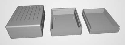

I'm the shadowy person doing the enclsoure that cheesestraws has been hinting about. Attempting here to do a snow white inspired design. It's intended to be 3d printed. Here's a render of the overall dimensions. There are details remaining to add such as holes for the ADB ports, holes for the LEDs, and mounting structure for the LED board.
