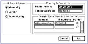

This may sounds strange but in the Mac TCP Control Panel instead of using EtherTalk A, instead use Ethernet Built-in. You need to manually enter an IP address from your network subnet, something like 192.168.x.z then click the "more button"and enter subnet mask of 255.255.255.0 use the manual setting and set the router IP and the domain IP. For domain name just enter a period and for the domain IP just enter your router IP.

MacTCP setup using manual settings and the choice in the Control panel of "Ethernet Built-in"
