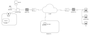

What about this one? The AppleTalk internet you see here consists of an AirTalk-"backbone", an Ethernet network and a standard LocalTalk network. I could have easily added more Macs, but I was somehow afraid that it might blow the fuse...:cool:
Routing is done by The Quadra and the Performa, both running System 7.1 and AIR 3.
robin-fo, can please explain how the air-talk and the Localtalk networks are physically connected to the Perfroma 475 router? Are they both plugged into the same port on the computer? I get that AIR is creating logical zones, but if the both zones are connected together then all the traffic on the wired zone is also on the AirTalk zone..
Using AIR, you can use both modem and printer port individually for LocalTalk. The AirTalk was connected using a standard serial ("StyleWriter") cable to the printer port. On the modem port, there was a standard LocalTalk box with only one of the two Mini-DIN 3 connectors used (as shown in the drawing). AIR was configured on the Performa to seed the "Compact Macs" zone on the modem port with network number 101 and to seed the "AirTalk" zone and network number 100 on the printer port. On the Quadra however, the printer port with the AirTalk attached was non-seed and the internal Ethernet seeded the "EtherTalk Zone" with network range 102-102. Alternatively the seeding of the "AirTalk" zone/network could have been done on the Quadra instead with the Performa only seeding the "Compact Macs".
Remember that the AIR is a router and not a bridge, so all networks connected to it stay individual networks
Thanks robin-fo! I learned something today. Never knew that the Macintosh hardware could support LocalTalk signaling on both ports at the same time. I wonder if doing this reduces the localtalk bandwith since both ports are using the same SCC chip. I will try to test this.
