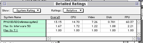

I dropped the booster into a newly recapped IIx today. Snug fit.
Performance is immediately noticeable in System 7.1. Norton shows a 67% overall performance boost (640x480 256 colors). Slightly better than the IIci.
The only problem is that sound is too fast. My test was to play alerts in the Sound control panel. I thought this would only be an issue is later systems. Maybe something about the IIx ROMs?
All in all, a really nice performance improvement. Keep up the good work!
