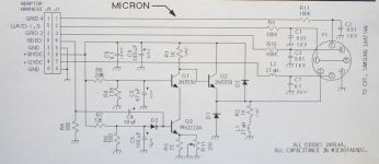

the sync signals have to be inverted, so youll need a 74HC04 of some sorts on the H/V Sync going to the monitor. Unless you modify the AB to accept straight signalling.
Also the video amplifier stage is a shunt-peaked based design which will work fine with an analog signal, however, the NAND gate that couples it has to be unhooked, as the NAND gate is digital. greyscale is analog. Once the nand is unhooked from the circuit, and the video amp is coupled directly to the signal coming from the video card, it in theory should work fine. Also the R-G-B signals need mixed with 3 100ohm resistors tied together into the video amplifier stage.
For Added bonus points: Run these signals, including the SENSE signals in analog muxing circuitry employing 4053s. This will allow you to switch the internal greyscale off back into standard on-board video and route to the external video connector. So if you dont want greyscale, you can switch it back to normal and use an external color monitor, by the flip of a toggle-switch.
Possible? its probable. Back in 2005 i think it was, I was modifying an SE analog board to run VGA, I never was fully successful because the resonance of the horizontal circuit isnt compatible with the VGA signalling and caused serious linearity issues, but vertical worked. And the picture was perfectly fine grayscale wise with the original video amplifier.
