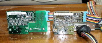

Well, now you get to start playing with the real goodies. I'll get pics up tonight if I get a chance. The lashup is pretty cool, if not altogether neat. [}:)] ]'>
Any questions? :?:
This will work for the vast majority of IIsi hot-rodders after we work the kinks out of the cable. However your Twin-Slot adapter opens up a possible hack almost as radical as my Radius Rocketized IIsi, Mr.B! [}:)] ]'>
Wow! That's quite a setup!
So you've got the Pivot card in the PDS slot, and PDS ethernet card in the Pivot's pass-through slot, with the ethernet back panel mounted at the rear of the case. Then the thick net portion of the ethernet back panel is removed, and the video cable from the Pivot fills the resulting hole.
What are the two smaller, dark green cards at the left in your 4th photo? They don't seem to appear in the other photos. I'm guessing maybe you have two PDS ethernet cards, and that's meant to show a side-by-side comparison of what it looks like with and without the thick net piece?

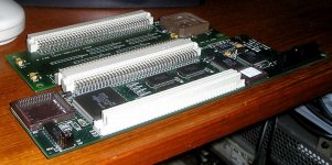

Hehe, what have you got in mind?
Thank you, and yup, got two so that pic illustrates he NIC's breakout card w & w/o the ThickNet section.
HEH! [}:)] ]'> I thought you'd never ask!
Take a somewhat less demented (if you should so choose) run at doing this . . .
file.php
. . . procure a "wrong angle" EuroDin connector from trag and solder it onto your inexpensive RCPII/IIsi card to do this . . .
. . . then install the flat-stacked pair of PDS cards into your twin-slot adapter like this . . .
file.php
. . . so the shorter NIC probably interferes with the stock exhaust fan housing . . .
. . . then replace the stock muffin fan with a more modern, thinner profile, quieter, higher CFM muffin fan . . .
. . . using the notched stock fan's housing as your card support. [}:)] ]'>
Any questions? [:D] ]'>
edit: oopsie! . . . forgot to mention the part where you install the fastest accelerator you can lay your mits upon into that lovely twin-slot adapter. [;)] ]'>
Gah! There will be several questions. I wrote that in a hurry before work today. :-I
You'll be modding the inexpensive RCPII/IIsi (for obvious reasons) replacing the "straight -up" passthru connector with the "wrong angle" adapter.The modified RCPII/IIsi Card will plug normally into the Twin-Slot Adapter along with your accelerator or cache card in the bridged IIci PDS Slot underneath.
The stock NIC (obviously, the expensive card remains safe from mad modification) plugs straight onto the modified RCPII/IIsi so that the two boards are in the same plane (as in the pic above) extending straight across. My guess is that the NIC, while shorter than the VidCard, will still conflict with the fan/shroud. But that's an easy mod that can very likely enhance cooling. The stock shroud should be retained either as ductwork for a larger fan located further inside the case or the housing for a same diameter, thinner, more efficient unit.
Anyway, that's it, whatcha think? :?:
