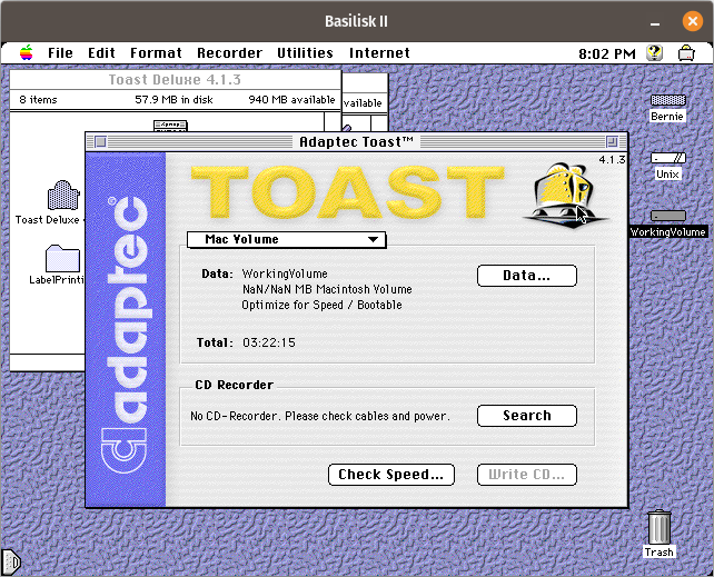

Otherwise, I just write CDs... Hang on one second...
That's over complicated because it is custom bootable CDs, but non bootable CDs are easier, and just writing a PC style disk straight from the modern computer and transferring files in resource fork safe formats like .sit, .bin etc is the simplest.
