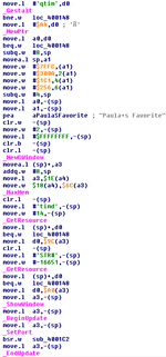

Yep, you'll see that text is also in my DingusPPC screenshot. It seems to be drawn by code in 'timd' resource ID 13. 'STR#' ID -16651 contains the text, and the code shown below loads it. Looks like it also titles the window "Paula's Favorite" but you can't see it.
I think the Paula's Desk Machine text would show up in About this Macintosh if you had a computer with that gestalt ID. 'STR#' ID -16395 contains text for each gestalt ID that shows up there. It provides some interesting insight about the various gestalt IDs. For example, both 47 and 113 are labeled as the 7100/80, and there are gestalt IDs for all the unreleased speed variants like 8100/60 for instance.
Here's the code that sets up the window.

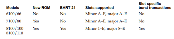

BTW, Apple's hardware dev note for the speed-bumped 6100/7100/8100 seems to indicate that the 6100/66 still came with the old ROM:
If that is true, it would indicate that this easter egg is likely only reproducible on a 7100/80, 8100/100, or 8100/110 unless you've swapped in a newer ROM.
