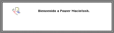

The actual 6100/66 gestalt ID ended up being 100 according to that same site, but it's not in the enabler's list. So maybe it only works on the speedbumped 7100 and 8100 models. We could also try hacking the enabler. I briefly tinkered with this in MAME but it froze. But I could tell it worked, because it changes the startup message to look like this if it loads:
I tried hacking the enabler so that my physical 6100/60's Gestalt ID (75) was in the list, but that caused it to hang at the Welcome to Power Macintosh screen just like I saw in MAME. It's probably because I have no idea what I'm doing with the enablers. It seems like what we need is for someone with a 7100/80, 8100/100, or 8100/110 to try that Spanish 1.1 enabler with System 7.5 and see if the "secret about box" easter egg shows the picture instead of the usual breakout game.
