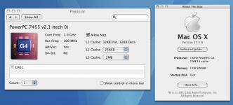

I was able to make some progress on this.  It is possible to enable the L3 cache after boot.  This is a 733MHz 1MB L3 DA card that I swapped the CPU and cache chips, and removed the flash chip so that it would boot:

I found a dual 800MHz quicksilver CPU card to play with.  I swapped in a couple 7455B chips and it's working now at 1.2GHz with the 2MB L3 cache.  The 7455B chips are much better than the original 7450.  They're both faster and cooler at a lower voltage.  This board has a microcontroller chip on it.  Does anyone know what it does?
