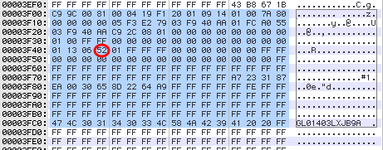

Perhaps this point is the ratio? Would the red circle represent the ratio? But if it were, I can't locate which parameter is the cache size.
