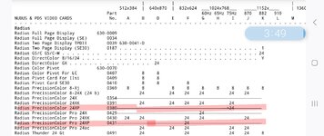

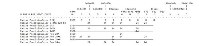

Hello Phipli, Thanks for your reply. I am humbled by the span of your knowledge, as you have weighed in on many of my questions. But I am confused by some conflicting info I am seeing. 1. in the thread (linked below) a card identical to the one I have is identified as a Pro 24X. 2. If it is a 24XP, shouldn't it support higher resolutions than 832x624 at 24bit? Gamba's site suggests. Clipping attached... not sure what the solid lines mean.

I think you're misreading the table? Your card is the Pro version, and there is an error on the non Pro row.
All of these cards use the same PCB and look absolutely identical, but with a different grade RAMDAC (big chip near the video out port) and amounts of VRAM. The board colours don't imply the card model.
Yours has a 66MHz RAMDAC chip which isn't rated fast enough to do 1024x768 or 1152x870. I haven't looked the VRAM chips up today but only one of the board models was fitted with the 66MHz RAMDAC, and that was the 24XP (and 24XP Pro which is basically identical), which is a 1.5MB board. I've previously done a load of work on these cards. My dad has a 24XP like yours. But blue.
