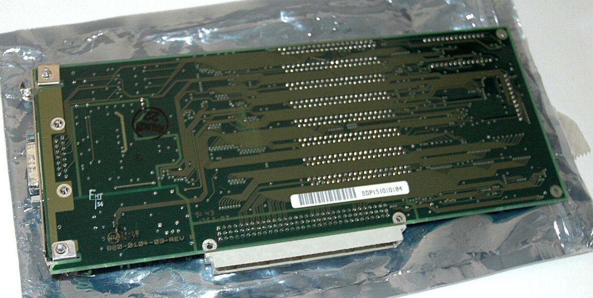

The card is a Radius PrecisionColor 8... don't see an XJ on the label. Wrote it to a 27C256 70ns EEPROM. Here's some pictures.
Ok yeah, they are two different cards. The standard 8 (non XJ) seems to be an 8 bit card that only supports 640x480 and 1152x870. Couldn’t find anything else online. Not sure if it’s accelerated or not. That explains why the ROM didn’t work.
Yeah, you have an older card with more in common with the PrecisionColor 8-24 than the later 7" cards.
