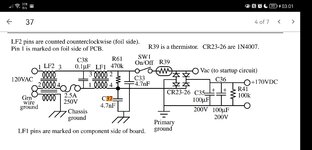

Hi,
I was just removing C37 (RIFA) from the 512K I recently bought.
It was blown, so I de-soldered it and also cleaned up some battery corrosion on the battery contacts.
After putting everything back together, I powered it up and nothing.
What do I do? Is C37 vital for the Mac to work?
Any help is much appreciated.
