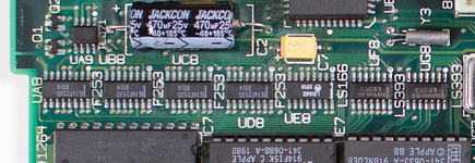

I have yet to test everything else on the system, but I am thrilled I have gotten this far in repairing a battery bombed SE/30. New things learned, and I have confidence to lift, clean, and replace chips and run a bodge wire. I think I did a fair job on that:
Thanks again for posting the link to that guide David Cook. While I didn’t really use it completely, I’m sure I will as I will be fixing up more of these as they come my way.
Nice and clean too. On longer jumper wires, I put a dab of conformal coating to secure them in place. On this one, it's short enough that you are fine as it is. Good job. Finding broken traces can be a challenge and takes patience.
I am happy but I’ll admit, this was far from a complicated one. The bad trace was actually a bad solder pad so it was visually apparent it was bad. Confirmed of course beeping it out but not like I had to do the full legwork to beep everything out.
Also this was not a severe battery bombed unit anyway. It looks as if it was stored on its side or upside down, all the rust was on the frame. So the board was largely spared.
Also, I got it to boot off a BlueSCSI and Snooper checks out completely for this guy. I think that’s about as good as it needs to be to call this repair done.
