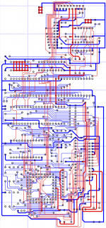

Dennis Nedry potentially sacrifices his HD20 controller board for the army...
This is a progress image, NOT COMPLETE. I have removed a large number of items from my HD20's controller board in order to visually get the circuits copied. That's the only reliable way that I'm aware of, and I have absolutely found traces that split off into multiple traces beneath chips and connectors, things that I would not have found any other way. This data will be an invaluable tool to learn more about this drive, and I believe that it will lead to the emulation of this drive some day, even if it is beyond my abilities and/or patience. I am okay at de-soldering but not a pro, unfortunately... There are several lifted pads. xx(
This was a FUNCTIONAL HD 20. I think I'll get it to work again, but if not I still think that it's worth it. If anyone has a seized up HD 20, maybe we could work a deal. I don't really want to put this board back together because it's a great reference for us. Also, I will not touch my Rodime drive, I won't even risk removing the board from it. If I can get one that's seized up solid, I would be able to take the board off and chart it out like this controller board, and that could help us figure out some pins. I did some very limited continuity testing on my Rodime and found 2 pins that feed directly to schmitt trigger inverter inputs, so already we know that those 2 pins are input-only on the drive. Taking the board off of the drive and removing the chips could tell us a lot more. I have no idea where most of the pins connect on the Rodime.
Anyway, when I'm satisfied with this graphic, I will then begin to verify some things stated earlier in this thread and post my findings in a useful way, possibly on the wiki and/or my website.
Red = front
Blue = back
Seen from front.
This image is complete but requires verification. I don't doubt that I missed a few lines. Some are very hard to see, for example, under a component I didn't remove or exactly under text/lines/etc. About half-way through, I discovered that if I put it up against my screen, the light shining through made the traces WAAAAY easier to see.
I am doing this in Osmond. It seems like an okay app for basically being free for this purpose. It's definitely not pro-quality, but it looks like it does okay. I'm open to suggestion if you know of some cooler PCB software on the freeware/shareware level. I've run into a few crashes and a few glitches after saving with this program, but nothing that I couldn't go back and touch up easily.

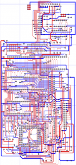

Is that a two layer board? I ask because it looks like the Gnd and Pwr busses are made of traces, so I'm guessing there are no separate Pwr and Gnd layers.

I'm in awe.
I hereby nominate your HD20 for a citation for the MLA Purple Heart with full bars & clusters.
Trag: Yes this is a 2-layer board. Holding the board up to a light source reveals no additional layers.
Bunsen: I totally agree, and that's the only reason that I could justify it. It also makes it more important to get something useful from this, so I'll be hard at work.
Important discovery:
The Z8 processor is not on the main address bus, and consequently does not directly control the address of the RAM or ROM chips. And the large chip contains all of the possible address and data lines.
The Z8, IWM, and PAL share a common 7.5 MHz clock. This clock is not shared with the large chip.
7 of the Rodime pins are connected exclusively to the large chip, and 9 Rodime pins are connected to the Z8. Some of the Rodime/Z8 pins are also connected to the large chip. Many of these Rodime pins have pull-ups or series resistors.
The plot thickens...... How could the Z8 execute from ROM without direct access? If the Z8 does indeed execute from the ROM chip, there must be combinational logic contained in the large chip that allows the Z8 to look through it to the ROM. The alternative is that the Z8 isn't in fact ROM-less, and the ROM chip is used for some other purpose. It did disassemble into code that seems to make sense, so I still believe that it does execute from the ROM chip.

Here is the Osmond file (will open as text if you just click it normally, so save the link):
http://www.d.umn.edu/~bold0070/projects/hd20/HD20%20Schematic.osm
Thanks for the info Gorgonops.
I was honestly looking for a clearer distinction between Rodime-related parts and Floppy Bus-related parts, but it seems that everything critical has its fingers in that big mystery chip. I think that from this, we know how the daisy chain port works and how I/O is managed through the PAL. Beyond the IWM, a lot of assumptions have to be made, and I'm not sure if that's the easiest approach anymore.
I didn't label pin 1 or draw part outlines or any of that. Please use a photograph as a part reference at least for now. I'll probably put this board back together at some point. It might take an extra wire here or there but I'm pretty sure it'll be okay. I did not destroy the board by any means, and actually I have a couple sockets on order so that I can easily take the PAL and IWM chips back out as needed.
In one of the photos in the link you posted, Gorgonops, the controller board has a socket for the Z8 and PAL. This makes me wonder if the Z8 isn't ROMless - I can't imagine any reason to be pulling the Z8 out frequently. Also, underneath my Z8, it has "820-0157-A" printed on the board. None of the other chips have this.
Anyway, at this point with the mystery chip sitting squarely in the way, a Mac Plus HD 20 ROM hack might be a more appealing approach. We are basically dealing with serial data, an encoding scheme, and control lines. We have some idea of the function of the control lines from the HD 20 board. It seems reasonable that a great deal of information about the encoding can be learned from disassembling the Mac ROM.
