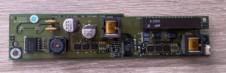

Here are the requested pictures.

Do you have a multi-meter, or the ability to do some soldering? If not, you'll need to find someone local or else ship that board. It might be more cost effective to look for a replacement.
The blown FET in your picture passes 28v to the VRM. If you measure the resistance across that FET I suspect you will find an open circuit. If you plug the VRM into that socket and measure from the 28v pins to ground it should not be a short. If this is what you find, you could jumper the blown FET to supply power to the VRM. At this point the Cube should be able to power on, and you can troubleshoot from there. If the VRM is shorted, then it's likely that the logic board is fried. The typical failure is the 28v line shorted to the 5v line through a dead FET. You could also use a multi-meter to check the resistance of the FETs on the VRM.

Q9 on the VRM looks suspicious. That said, if you can't solder, what you're essentially asking is "will anyone here take a look at my board if I ship it to you?". In any case, for that FET to grenade, the VRM is probably also shorted. Good odds of the entire thing being toast. Power circuitry failures are usually terminal.
