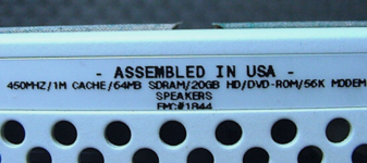

I've been looking into this since 2020 when I discovered the DAC and the amp chip on the board when doing a repair to it. Even spoke with Hap who has the prototype with the speaker. I got high res photos of the board from him and he started it up to find that there was no sound. My understanding from various rumors I found across the net is that the DAC is there purely for the initial startup chime and that's it. That's why you can only get the chime from the official mac dongle and a very select few 3rd party ones.
This site goes over the 68k and PPC boot process: http://educ.jmu.edu/~jarvislb/utils/macintosh/boot2.htm and the startup chime happens before anything is loaded (most notably the ROM) or any major diagnostics are done. So it would make sense that only the apple dongle would chime as the chime happens even before the USB hardware is initialized.
So what I think is happening, is that the board powers on, turns on the DAC, plays the chime over the USB ports, then shuts it back down. I think the change to external speakers from an internal one was far enough into production that it would have cost more to remove the amp and the speaker connector than to keep them. If it had ever got to a 2nd revision of the motherboard I suspect they would have disappeared.
But the main thing here is that all the communication with the DAC is done at the very beginning before any hardware diagnostics (beyond the most basic) are done or Open Firmware is loaded. So when dealing with dumps from the motherboard firmware, we'd need to be looking into the absolute initial bootstrapping code to find anything that is talking with the DAC. I don't know if any of the firmware updates for the Cube go that deep.
The DAC's i2c and i2s lines are still connected, so in theory we could talk with the chip through those buses in Open Firmware to turn it back on. One would hope that it would just show up as a sound device in OS 9 after that if removing the internal speaker close enough to final production that they left the drivers in. Unfortunetly I'm not much of a programmer and I definitely don't know much about low level programming, even more so in Open Firmware. Over the last 4 years I haven't found much in resources on low level programming on the PPC Macs so I haven't been able to get farther than that.
