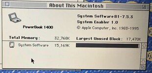

I've just realised, now that I've upgraded the main PowerBook 1400c to 166MHz, I understand it won't run Mac OS 7.5.3? I'm asking because my internal drive (an SD card) has both 7.5.3 and 8.1 and of course, before now I've been able to switch between them.
Now I'm wondering that if I try to set Mac OS 7.5.3 as the startup folder (which is possible using the control panel) and reboot, it'll fail to boot and then fail to find Mac OS 8.1 on the other partition.

If you unbless 8.1 it won't find it while trying to boot.
If you want to test, create a RAM disk, copy a (reduced?) System 7.5.3 onto it and reboot from the RAM disk, keeping 8.1 as the boot system on the hard disk.

Well, this is truly astounding. Not only the ability to boot from a RAM disk, but also being able to use it essentially like a Virtual Machine. It worked! I created what I thought was a fairly minimal System 7.5.3 on a 12MB RAM disk and then set it as the Start Up disk. It booted to it.
So, then I booted from my real System 7.5.3 partition; that worked too and surprisingly the RAM disk was mounted too. Then to make sure, I rebooted from System 8.1 and that worked. This was my reduced System 7.5.3 (though seen here after booting from the real System 7.5.3 partition):
I guess it could be cut down further. I figured the PowerBook 1400 Enabler would be needed and some basic Control panels. I've forgotten to list the Apple Menu Items on that screen shot, but initially I didn't have any and it booted, but then I added some basic ones and rebooted OK. It was about 6.5MB uncompressed.
This raises the question: can all PB1400/166s boot from 7.5.3 if they have that Enabler? If not, what's special about the ones that can't?

I suspect they all can, same as the 9600 can boot 7.5.3.
The confusion is apple publish the Minimum OS... That isn't the same thing as the minimum bootable OS, although they can be the same, what it usually is is the OS it Shipped With.
In the case of the 9600s, all boot into 7.5.3, because they're basically a 9500, but Apple and everyone who quotes Apple says 7.5.5 and even 7.6.1 for some variants of 9600.
Never believe what you read on the internet. Always test. Nothing like primary evidence.
I'd recommend 7.6.1 if you want the System 7 experience, as I've found 7.5.3 to be somewhat crash-prone on my 1400 at least. My understanding is that there's more mature PPC code in 7.6 onwards.
