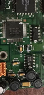

Say, how did you get your solder joints looking so nice? Even with lots of flux mine just didn't melt well... probably time I get a better iron? Eh. the current one does get the job done. It does fine when there aren't giant ground planes.
Lots of practice, I guess, though I didn’t find it any more challenging than any other recap I’ve done.
Maybe your iron isn’t hot enough. Are you using leaded solder? Flux really does wonders, usually.
When I have trouble with ground planes wicking away heat, as I recently did on a PC ATX motherboard recap, I’ll get out the hot air station and assist the soldering iron with a bit of additional heat.
I guess my iron isn’t hot enough when doing these giant ground plane things, only explanation I can think of really. Also the tip I used is very fine but I sort of had to to fit everything. My soldering usually comes out much better - here’s a photo of my PowerBook 100’s board
I have my iron around setting 4/5 (it doesn’t do a temp readout) already though usually.
It could be that your tip is too small, maybe? Bigger ones do deliver more heat.
The one I was using almost certainly is - I just was concerned about space. Probably could have made the larger one work though, that small one really isn't great.
