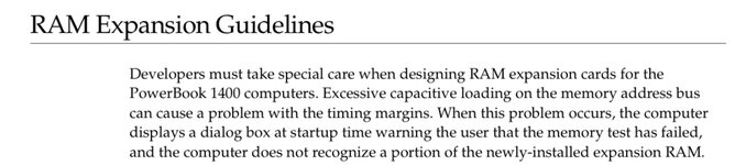

I was mucking around with my 1400c today and came across something interesting. I installed 8MB system RAM and 2x 32MB expansion cards.
To begin with my system would crash on startup until I disabled extensions. After booting into the system it recognised that 80MB RAM was present! (8MB onboard, 8MB system, 32MB x2 expansion memory).
The unfortunate thing is that the system is very unstable and doesn't seem to be addressing the RAM correctly. It crashes often when allocating memory and will only boot with a minimal system. I've tested this on both OS7 and OS 8.6 and got the same results.
Is there any way this can be addressed so the full amount of memory can be utilised? I am using a Sonnet Encore so I'm not sure if that has anything to do with the issues described.

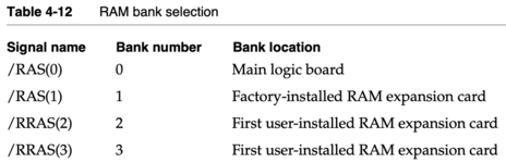

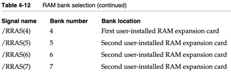

I don't think it's possible, because of the PBX memory mapping chip. If we go back to the developer notes for the PB1400allVersions:
index.php
Every Macintosh from the original 128kB Mac onwards had to perform some physical to physical memory mapping. On the 128kB Mac this was needed because the 68000 CPU booted from address 0, so ROM has to be there, but normally they wanted RAM there with ROM at 4MB. So, those early Macs started by mapping the ROM to both addresses and used a single bit in the VIA chip to disable ROM mapping, while enabling the RAM mapping at 0MB. So, then the Mac could boot and the first thing the ROM would do is make it jump to 4MB and then flip the VIA bit to enable RAM at 0MB.
As Macs became more complex in the Mac II era and later when Macs had multiple SIMM memory slots, the physical to physical mapping needed to become more complex. For example, on a Mac Plus, each pair of 8-bit SIMMs is a single bank of 16-bit wide RAM, so the 4 SIMMs make up 2 banks and each bank must be physically selectable. The Mac Plus uses actual resistors to make sure that if the first bank contains 0.5MB of RAM (2x 256kB SIMMs), the second bank's addresses start at 1MB and can only be 0.5MB in size. With 2MB or above, the first bank must contain 2MB and the second bank can be 0MB, 0.5MB or 2MB.
On the PB1400 models this physical mapping hardware is a chip called PBX. It contains 16 bytes x 2 x 4-bit entries for 32 x 2MB (=> 64MB) physical RAM slot and each entry is the bank number of the RAM module. Each bank can be up to 16MB. There's bank 0 is for Motherboard RAM (8MB) bank 1 for the Factory RAM card (usually 4MB or 8MB, but I think 12MB or 16MB is theoretically possible). Then banks 2..4 and 5..7 are for the user expansion RAM expansion slots. e.g. a 64MB fully expanded PB1400 might have PBX set up as: User2 Bank0
Physical Addr0MB2MB4MB6MB8MB10MB12MB14MB
0MBMotherboardMotherboardMotherboardMotherboardFactoryFactoryFactoryFactory
16MBUser1 Bank0User1 Bank0User1 Bank0User1 Bank0User1 Bank0User1 Bank0User1 Bank0User1 Bank0
32MBUser1 Bank1User1 Bank1User1 Bank1User1 Bank1User1 Bank1User1 Bank1User1 Bank1User1 Bank1
48MBUser2 Bank0User2 Bank0User2 Bank0User2 Bank0User2 Bank0User2 Bank0User2 Bank0User2 Bank0
So, although you could therefore put 8MB + 16MB + 2 x 48MB in the PB1400 (120MB!!!) the real limitation is the 32 x 2MB RAM slots that the PBX chip can manage. Trying to do more will cause physical memory to overlap addresses, which is probably what you're seeing here.
Having said that, specialised software (perhaps a specialised Extension or System folder INIT) could be used to access up to 120MB of RAM on a PB1400, though only 48MB could ever be recognised by Mac OS (the rest would be a RAM disk). How might we do that? The answer is that we'd force the OS to recognise only the first 48MB of slots in PBX, but the specialised software would bank-switch in other banks into the last 8 slots as needed:
