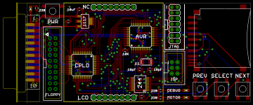

Whew! It took me a long time to do the board layout, but here it is! The board is about 4 x 1.75 inches, or roughly the size of an elongated credit card. The resistors, LEDs, and odd-sized capacitors are all labeled, so any other small rectangular surface-mount parts you see are 0.1 uF decoupling capacitors.
Anyone see any problems or have any suggestions for improvements, before I send this off to be manufactured?
If you look at the photo in this thread's first post, the CPLD replaces the Altera board shown at the left. Its main purpose is to decode the register select signals from the Mac, and handle reading/writing of disk registers, because the AVR isn't fast enough to do it. It also performs serial-to-parallel conversion in both directions, so the AVR can work a byte at a time, without having to worry about the serial data timing requirements.
I'm using the same Xilinx CPLD as this demo board: http://dangerousprototypes.com/2011/03/29/new-prototype-xc9572xl-cpld-development-board/
I thought of one more possible layout improvement- it might be handy to run the 4 unused CPLD pins to a header somewhere, in case I need them later for anything unexpected. I'm not sure there's still space for that though. :)

Thanks! 244 is a 74LVC244, which is acting here as a 5V to 3.3V level converter.
