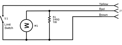

Did you consider just reusing the floppy mechanism (Eject motor, brackets, etc)? You could repurpose the disk switch to detect the inserted case. You would just have to replace the actual floppy with something holding the display/etc.
i had one non-working drive that i decided to dismantle: i couldn't figure out how to just get the mechanism separate. Worth another try, but drives are limited.
the bigger problem is: the servo just doesn't have enough torque to push the existing metal cage around. It can flip a wee switch, but not push that eject button—you only have 5V @ ~300ma, and you have to share it: to much draw trips the power and resets the Floppy Emu.
A custom mechanism would be the most fun & provide the most control. Also, it's more difficult & fraught, so: that's The Chadwick Way.
I see. I was thinking you could reuse the existing eject motor as it seems pretty strong, then you also wouldn’t have to push for eject as you could just trigger the motor in the same way the drive does now.
