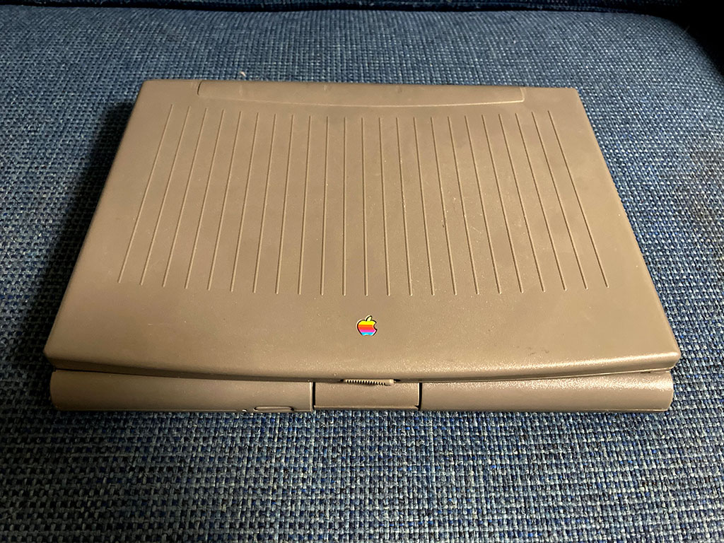

Picked up the PowerBook Duo 270c yesterday. 70 mile drive to do a simple porch pickup.

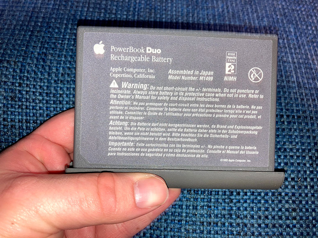

It came with the power supply and a battery. Unfortunately, no docking station was included.  :(  However, the laptop and accessories seem to be in decent condition. As per everyone else's advice, I'm not going to attempt to power it on until after I have it recapped.

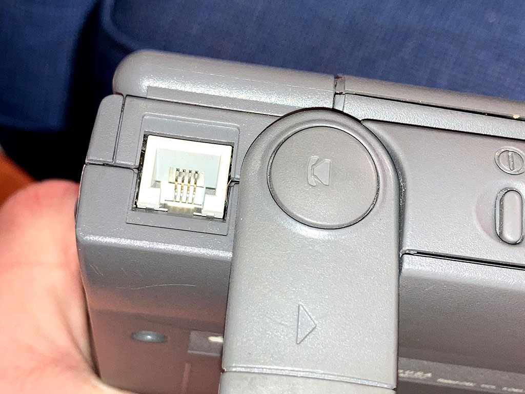

It also has a modem installed, but I'm going to guess that the modem was a standard feature on Duo models?
It was not standard, it was an added option. My 2300c has a blanked modem port there behind that leg.
Any chance you've ever had it apart? I'm dying to see what the non-modem equipped Duos have in the expansion slot. There must be something there with at least the power button on it. Could provide some useful clues for my ongoing wifi modem replacement hack attempt :)
