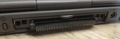

Project Beginnings: I started this project by sourcing the connector mentioned in the Macintosh Duo System Developer Note, the JX20-152BA-D1LT-H. I found a similar connector (a JX20-152BA-D1LT-HA) on an online component reseller. While not an exact part number match, it seems to fit:
The cost of this connector is considerable at about $80 USD/piece. This means the DuoNet will never be a manufactured product or a kit; the cost of components means this will be either a one-off or extremely small batch. I will however, open up all the files for you to build your own.
