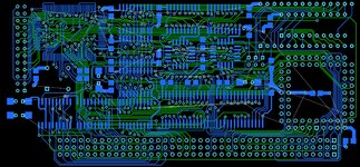

If you feel like sharing the schematic once it's complete I wouldn't mind staring at it for a few minutes and making a wild guess what the registered one might do.
Yep, I'll upload it once I stop being stupid and getting turned around halfway though.
Here's what the current progress on the board itself looks like:
Along with the original scan:
There's a lot more going on in the inner layers than I anticipated, so it's going to take a bit to get it fully complete, but I should be able to at least get all the GAL connections mapped out.
