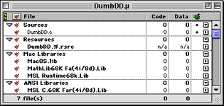

For fun I wrote a version of DumbDD in THINK C 5. It's <4kB and fairly crude. I transcribed the Forth routines from MacTech I linked earlier, but I have almost certainly made mistakes. I tried it on miniVMac with the actual SCSI writes blocked out (and a delay of 2/60ths of second between each sector) so I could watch it update, but the version of Dd and the project attached would do it for real (find the #if 1 in the .c and turn it to #if 0 to reenable dummy writes). I tried to try it on InfiniteMac emulating a PM6100, but I mucked something up and now it won't boot properly with Saved HD. It thinks there could be another instance in a different tab using it, but there isn't another Infinite Mac tab and I don't know how to find and delete the Saved HD cache file ( @mihai , @joevt I'm sure you know). Also the BlueSCSI support crashes now, so I don't think I can get anything in or out. I'm not yet brave enough to try it on a real Mac.

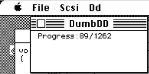

You can quit mid-way by choosing File:Quit, or by closing the window. Progress updates every 0.5s. I think I'll change Dd:Copy to Dd:Transfer, because obviously Copy belongs on the Edit menu, but I didn't want Dd to be considered an 'Edit'. You can do stupid things like switch the SCSI device mid-transfer and it will happily trash another disk half way through, so take care! In future updates I would disable those menu options during transfer, add a Filename and SCSI ID to the window update (and maybe a progress bar). I would also support Option+'.' to stop a transfer without quitting and/or Dd:Stop .
Here's the app and project as it currently stands.

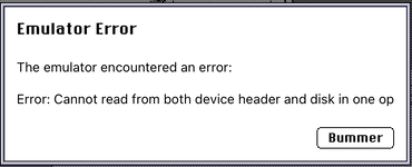

However, when I try and read from SCSI via Infinite Mac's Snow Mac IIcx emulator, I get:
That's an Infinite Mac error message. It's not from Snow. That's a bug for @mihai to fix.
I think device header means the part of the virtual SCSI HD that is not the HFS or HFS+ partition? i.e. the Apple Partition Map which is generated programatically if a disk image does not contain an Apple Partition Map.
I suppose you can work around this by changing your code to not use block ranges that cross partition boundaries? That means you need to have code that understand the Apple Partition Map. Or you would have to read one block at a time, which is probably slow.
OK, I'll add a Dd:Blocks... field to support starting blocks, then I can get it to read or write into the middle (or near the end) of the HD image and skip the APM. Though, actually it should indeed be possible to read the Apple Partition Map. TattleTech seems to work, I used it to get the SCSI IDs for the drives, but it also seems to return quite a lot of data I'd only expect from making direct SCSI commands.
I didn't say you could not read the Apple Partition Map. I said that you cannot read from the Apple Partition Map and from the next partition in the same command.
Below is output from my fork of DingusPPC. MetaImgFile lets you construct a virtual disk comprised of multiple disk images by constructing a partition map in RAM. Each part of the virtual disk is a "chunk". In this example, there are 7 chunks. The first chunk is in RAM and contains the constructed Apple Partition Map and the Mac OS 9 drivers. The next 5 chunks are disk images that each contain their own Apple Partition Map which is not included in the virtual hard disk. The last chunk "Infinite HD" is from a disk image that does not have a Apple Partition Map. MetaImgFile handles reads and writes that span chunks. EmulatorWorkerDeviceImageDisk in Infinite Mac does not?
So if you want to implement the suggested work around then you can try parsing the Apple Partition Map. The device header probably ends where the first non-driver partition begins. This is slightly more involved than what I said earlier - I said the device header ends after the partition map but I think it ends after the last driver partition.
Can you set the copy block size to 512 bytes @Snial? Then the boundaries should (except if a driver uses really, really weird formatting) always match.

@joevt , @Phipli : thanks for the replies. I've updated DumbDD so that I can specify the first sector (attached). All the sectors are assumed to be 512b and I'm assuming the sector size for Saved HD is 512b too. In my new test I set the first sector to 8000000 so in theory it would have scribbled half way into Saved HD, and I guess missed any of the few files I had in there.
Now at least it doesn't crash :-) .
I Uploaded both the source file and the data I thought I'd written using DumbDD. However, they don't match. Not sure what's different yet, but I have to dash, so I'll just leave the new application attached.

Anyway, here's my current code and in case CW 11 Gold isn't project compatible with whatever CW you use here's an image of the project.
