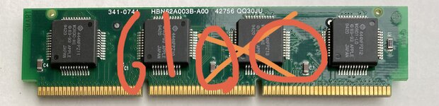

Does anyone have a 7500 ROM SIMM and if not are there modern day programable ones?
I was googling for this 341-0741 and found a 256k cache …
It isn't the same thing. 341-0741 is usually the board for a Nubus mac ROM, but the form factor stayed the same through the beige era. As it has 4MB, it isn't necessarily a Nubus PPC era ROM but might be, and it absolutely isn't a cache because it has ROM chips.

I suspect it is from a 6100 or similar and would boot it. You are really looking for a custom written ROM because 7500s just came with soldered ROMs. Ones people have in drawers are just goung to be almost all Nubus or G3 ROMs.

I'm not sure, but it might be possible to solder the four chips from another 7500 onto a 6100 ROM SIMM? You'd have to get the order right.

you were right it is not a cache… tested in a 7100
