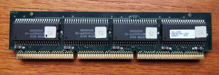

It would be great to make a ROM reader so it was possible to read them without putting them in a computer and know exactly what they are. All the 6100 ones will work in any 6100/7100/8100 so they're easy.
The odd one is the one I singled out, it almost looks aftermarket. I hoped it was rewritable but I don't think it is.
I would suggest asking for one and replacing the chips with ones from a donor board. So you would want one that is wired right and has the right footprint for apple stock 7500 ROMs.
I wish I can make a new one with programmable simms but it’s so strange because there’s no telling what is and isn’t wired right

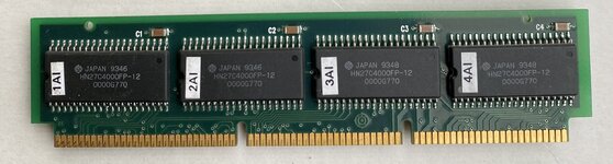

This one really intrigues me.

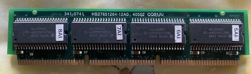

@slomacuser can you photograph the other side?
The issue is we don't know what it is programmed with, but it is similar to a weird ROM I had in an 8600 (which doesn't need a ROM SIMM).

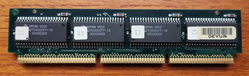

This is mine :
its similar but you can tell it’s different by the chip orientation
Chips are oriented the same way. They're not the same PCB layout though, but same chips and almost identical. You need to be comparing my second photo with slomacuser's.
I see what you mean now very bizarre what did yours do?
It was in a weird machine that my dad was possibly conned with. It was an 8600/250 "mach5" logic board that someone had fitted to a 200MHz processor to. The 200MHz processor is electrically incompatible with the logic board. I suspect that Apple made the computer fail to boot with the wrong processor, but someone cloned an 8600/200 ROM and fitted it so the computer thought it was the older type 8600.
The powersupply failed after a couple of months, likely due to the wrong processor being fitted. My dad ended up getting another 8600/250, this time fully as it should be. The weird dead machine sat on the side for decades until he sent the logic board to me for something and I was confused why it had a mach5 board, non-mach5 processor and a ROM in the slot and on the board.
Thankfully the board still works.

@slomacuser are there chips on the other side of this one?
If there are it might be what is needed, although may need reprogramming.
Edit : no, sadly it is single write ROMs. It isn't reprogrammable.
