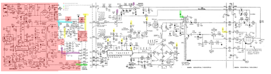

Cool project, curious to know how you've connected stuff around the LM317?
I think maybe in my final build I was injecting power into the lm317 input.
I'd have to check the schematic but from memory it has soft start circuitry on the adj pin.

Yes, i retained the LM317, but i removed the 12v reg for efficiency's sake and combined all 12v rails into one, including the one on the heater, the 12v rails on the deflection IC and the softstart RC circuit in LM317's ADJ pin. I supplied the usb-pd's 20v to the input of LM317 and it seems to work. But i have plans to remove that chip and replace it with a better switching reg with current limiter (my measurements indicated around 17-18v with 0.4A current limit).

I looked at the schematic after I sent my last message and saw the other 12V reg, I don't think I'd even noticed it before.
My intention was to reduce complexity and replace it with modularity, your mods push this even further.

I will list down the mods in a modified schematic of EAB later soon, hopefully folks can try it to save classic analog boards that are screwed by their broken PSU circuits :)
WARNING: If you dont know how to deal with high voltage stuff, please stay away from this thread. I am not liable for any injury or damages resulting from the use of this information.
With that out of the way, this is the culmination of all my mods to make the Early Classic Analog Board run without that pesky temperamental power supply circuits. Hope this would be a useful guide for y'all!
I was working on the Classic analog board a while back, I was planning on replicating the PCB (and have modern schematics) so that you can repair and diagnose these machines better. Seeing how it's possible to run both the logic board and CRT power without requiring a majority of the problematic components, I wonder if it would make more sense to design a modified PCB which uses a modern power supply for the voltage lines.
The Bomarc schematic can be a bit unclear on the voltage lines, so I appreciate your work on the diagram.

It should be possible! I mean this thing runs on a single USB-PD charger right now so integrating a better and modern power supply circuit on a brand new PCB would be really kickass!
I also think everything except the flyback and the CRT connectors can be replaced with SMD resistors and probably tantalum caps as well. It'd be exciting to find out if those components will work :D

I think it might be preferable to use a standard barrel jack or IEC plug for power input, as you could more easily gurantee sufficent power can be delivered compared to USB-C, but USB-C is still an option as many people nowadays probably own something capable (laptop power bricks and the like).

There's prior art with this Mac SE & SE/30 version: https://github.com/dekuNukem/PicoRC/blob/master/mac_se_se30.md
I'd imagine it'd require some pretty light changes to make it work with the Classic & Classic II
Sadly that was not the case with my early investigation on this project due to how integrated the analog CRT and power boards are. I had to desolder anything below the lower half of the analog board to power up the CRT circuits cleanly.
The earlier classic Macs can get away with a PicoATX since they have an ATX supply port.
The project that I linked provides the connection for a PicoATX to connect to the analog board. I've got one of these in my Mac SE/30 and there's no requirement to desolder anything on the analog board at all to make it all work.
the point is that the classic and classic II have an integrated PSU, kind of like the Plus only done much cheaper. So there's nowhere to plug that in.
Exactly :) just as @cheesestraws said, both power and CRT circuits are integrated into one board, there's no way to wire or plug that PicoATX thing in at all without removal of certain parts on the voltage rails.
