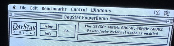

Interesting, although after using this method to “turn on” power cache, power demo reports the external cache is enabled:
The cache control register might reveal something.
Dropping into Macsbug and typing CACR will show the contents.
