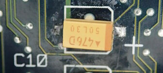

The Mac IIcx is easier to diagnose power problems because the power on/off circuitry is not underneath the power supply -- unlike the Mac IIci. With a little probing, I determined the issue was in this portion (image below) of the power-off circuitry. Pin 4 of UL2 is supposed to slowly rise to 5V after power up, to act as a delay before it will honor a power down. Otherwise, pressing the power button would immediately toggle between turning on and turning off. On this IIcx, the Pin 4 signal is always low.
After powering off (by pulling the power cord), I checked the traces, measured R26, and measured C10. Capacitor C10 is shorted. But this is a brand new capacitor rated at 5x the voltage. Do you see the short in the image below?
If you don't see the short, it's because it is covered up by the capacitor. Upon removing the capacitor, I discovered something really weird. You know how sometimes a part of the leg of an old capacitor is still stuck to the pad when decapping? I am usually excellent at removing all remnants. This time, I must have missed it. The old capacitor leg remained and bridged the pads of C10 when the new capacitor was installed. I could not have made that happen if I tried.
Upon reassembling the IIcx, everything worked perfectly, including powering down.

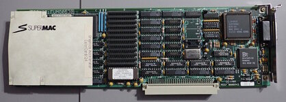

Time to swap in the SuperMac ColorCard! *** NOW THE IIcx WON'T POWER ON ***
Uh, oh. The seller was kinda right. The IIcx won't power up with the ColorCard installed. The power supply is producing the telltale click, click, click when it detects a short.
The multimeter indicates a short on the 12V rail of the card. Fast forward: capacitor C78 is bad and is shorting the 12V rail. But why? The answer is in the image below. (No stray metal pieces this time.)
Take a look at the capacitor rating.
SuperMac installed 10 V rated capacitors in 12 V situations! Tantalums should be twice the rating -- they absolutely must not be underrated.
Replacing both capacitors with properly rated replacements fixed the card and the allowed the IIcx to power up. Thank you Astec power supply for preventing a fire.
If you have a SuperMac ColorCard check for this factory error!

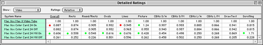

However, the performance is stinky. With 256 colors (the Norton Utilities default), the card is slower than the stock Apple card, except for drawing a picture when acceleration is on. This shocks me. Why would any card be slower than an unaccelerated vanilla card?

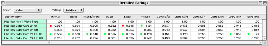

As would be reasonably excepted, the performance is even slower with millions of colors. Except, scrolling with acceleration is faster than in 256 colors. Acceleration in millions helps in all cases except CopyBits. I guess Norton copies from local memory to the card, whereas scrolling is entirely within video memory.
In summary, for 256 colors with this ROM and Control Panel, the SuperMac ColorCard 24 performs poorly and is barely accelerated. I suspect this was targeted primarly at millions of colors usage.

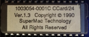

After some digging, I found my board - and luckily, it is v1.3! For some reason, I thought it was v1.2. Attached are the files from dump of my production ColorCard/24 v1.3 ROM -- including:
- binary file
- inverted binary file
- motorola srec file
The ROM size for ColorCard/24 is: 27C256
On Windows, srec_cat is a very useful tool for dealing with ROMs.
See: SRecord Tools Download
@MacOSMonkey definitely welcome back!
You set me up for success by suggesting using a 27C256 and providing the .bin file. It worked perfectly, the first time. The SuperVideo software recognized and displayed the version as 1.3.
That was the good news. The bad news is the performance is unchanged.
1. I tried the same test conditions with the same test results.
2. I switched to SuperVideo 2.07 with Accelerator 1.0.1. Same results.
3. I even tried 256 colors without any software. Same results. This suggests no acceleration in 256 colors.
From this, I conclude the updated versions of firmware were bug fixes, rather than performance enhancements.
- David

Regarding your benchmarks, they generally show that ColorCard/24 in 24-bit accelerated mode is around 2x faster than Toby, extrapolating linearly to estimated 24-bit operations from your 8-bit timing (or giving Toby a baseline value of 0.33 for 3x the pixel data vs. 1.0 at 8-bit). The only things that will be accelerated in hardware will be on-screen transfers (source and destination on the card, especially including CopyBits and Region operations of all types). As you observed, CopyBits operations from main memory to the card are not accelerated, because the source is not the card and it requires a NuBus transfer. At release, it was at the top of the performance curve.
In terms of software speed-ups, you an see the impact on picture drawing in 8-bit mode with the "accelerator" enabled (not hardware) vs. the 8-bit Toby board. QuickDraw had certain inefficiencies that allowed for better software optimization.
