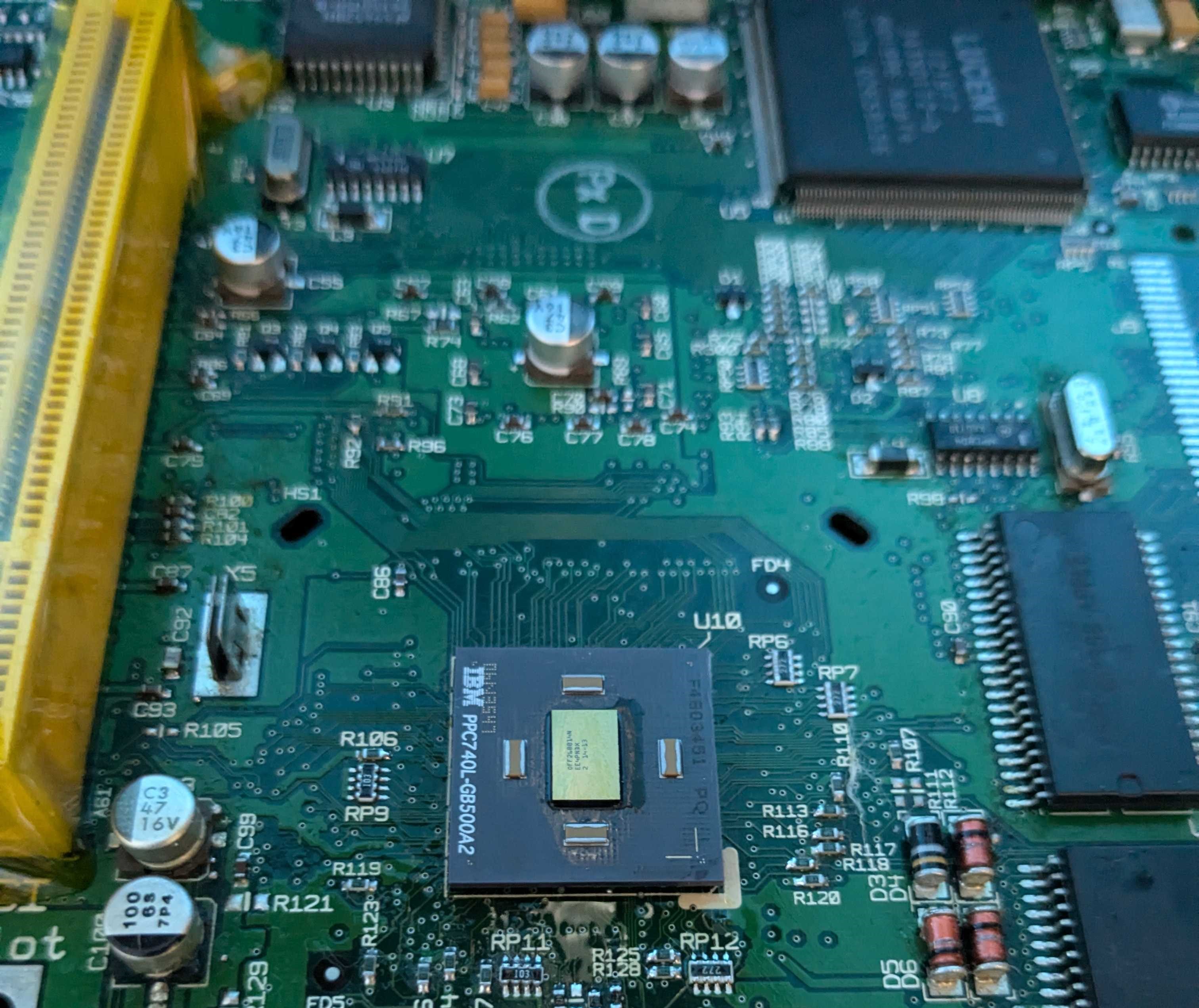

Today's swap was a PPC740L-GB500A2 fitted to a Performa 6500 logic board.
The picture above is a bit of a lie, this was on another 6500 board that sadly seems dead, as it wouldn't boot with the chip fitted.
I tried fitting a PPC740L-GB300A2 to that board earlier, but it didn't work either and I thought it was due to slight die chipping on this 300MHz part.
That chip may yet still live then, so worth investigating!
I put the PPC740L in place of an earlier MPC740ARX266 swap on a different 6500 board, so that Motorola 740A will too go back to the collection for a reball and potential future BGA swap.

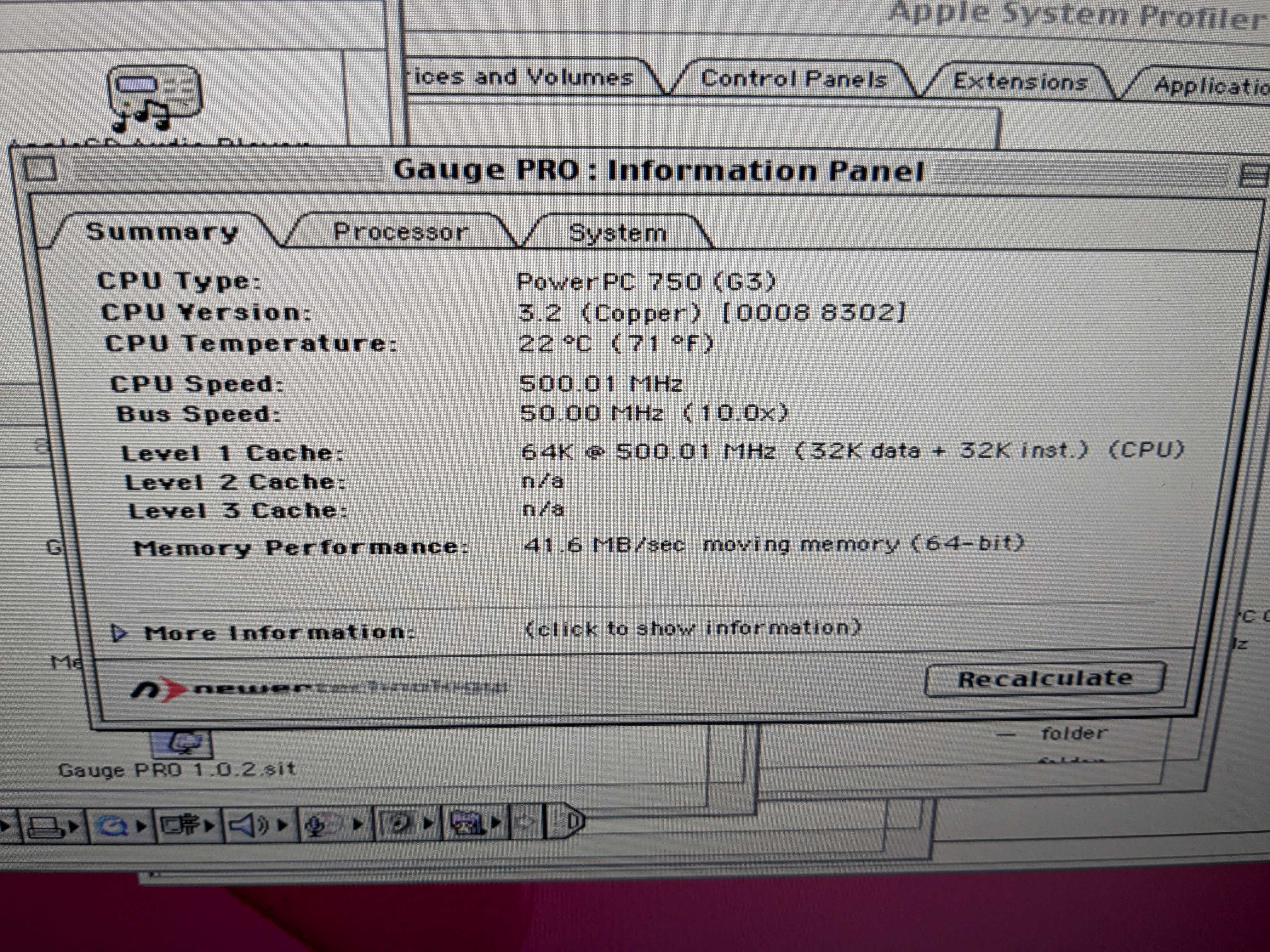

The PPC740L reuses the PLL multiplier setting for 2.5x for 10x, so setting it to that will result in the full 500MHz clockspeed on the 50MHz bus of the 6500.
Sure enough, while System Profiler assumes the 2.5x setting and thus shows 125MHz, Gauge Pro shows the true speed of the G3!
This board has had its ATi Rage II chip pulled, as it has VRAM trace damage causing distorted graphics.
I could try and fix it, but I am planning on rehousing this board into an Evercase ECE0229LP mATX case, and reusing the PCI resources for a third PCI slot.
This will make it my very own Gazelle-based G3 Macintosh Clone of sorts :-)

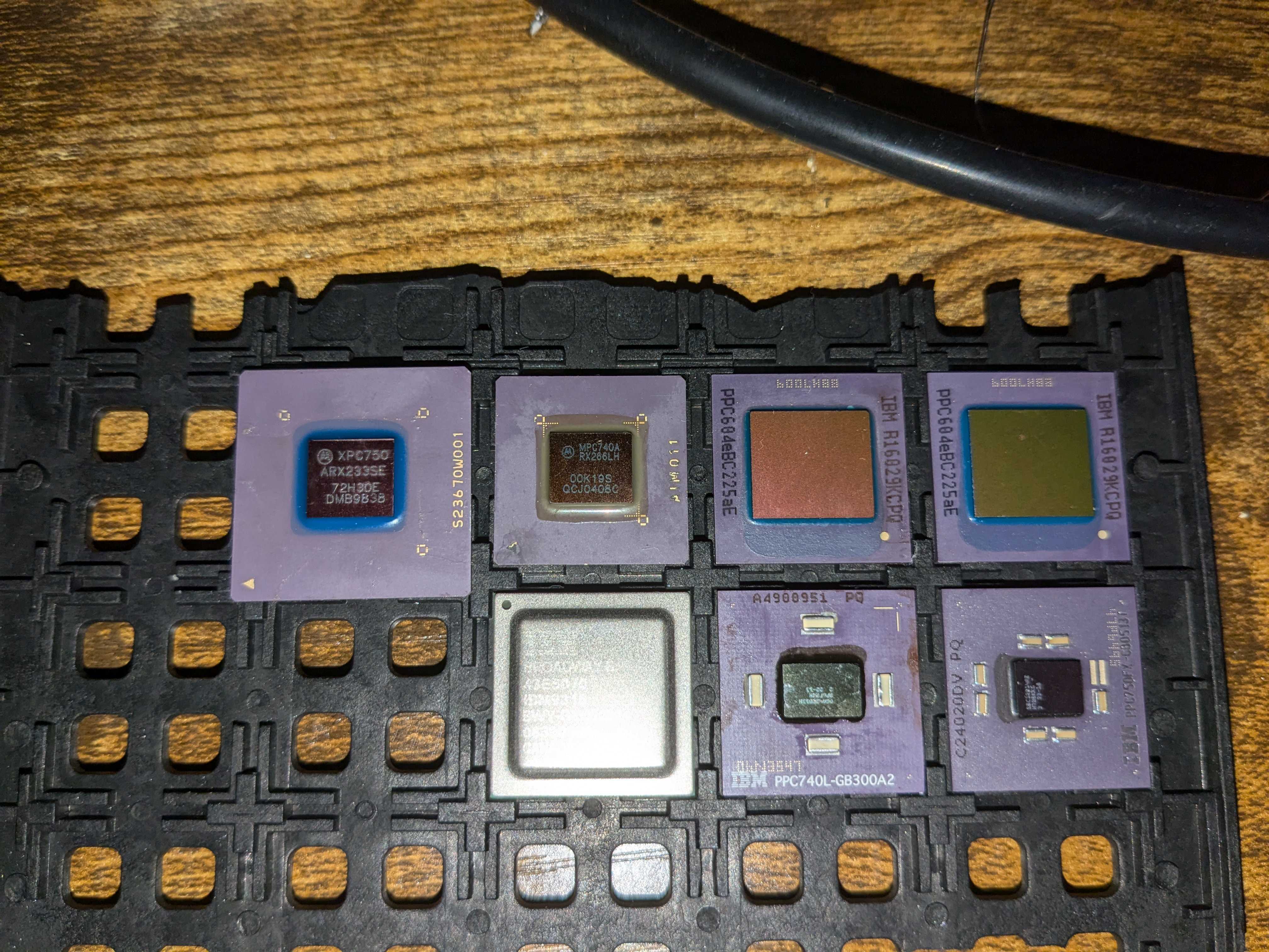

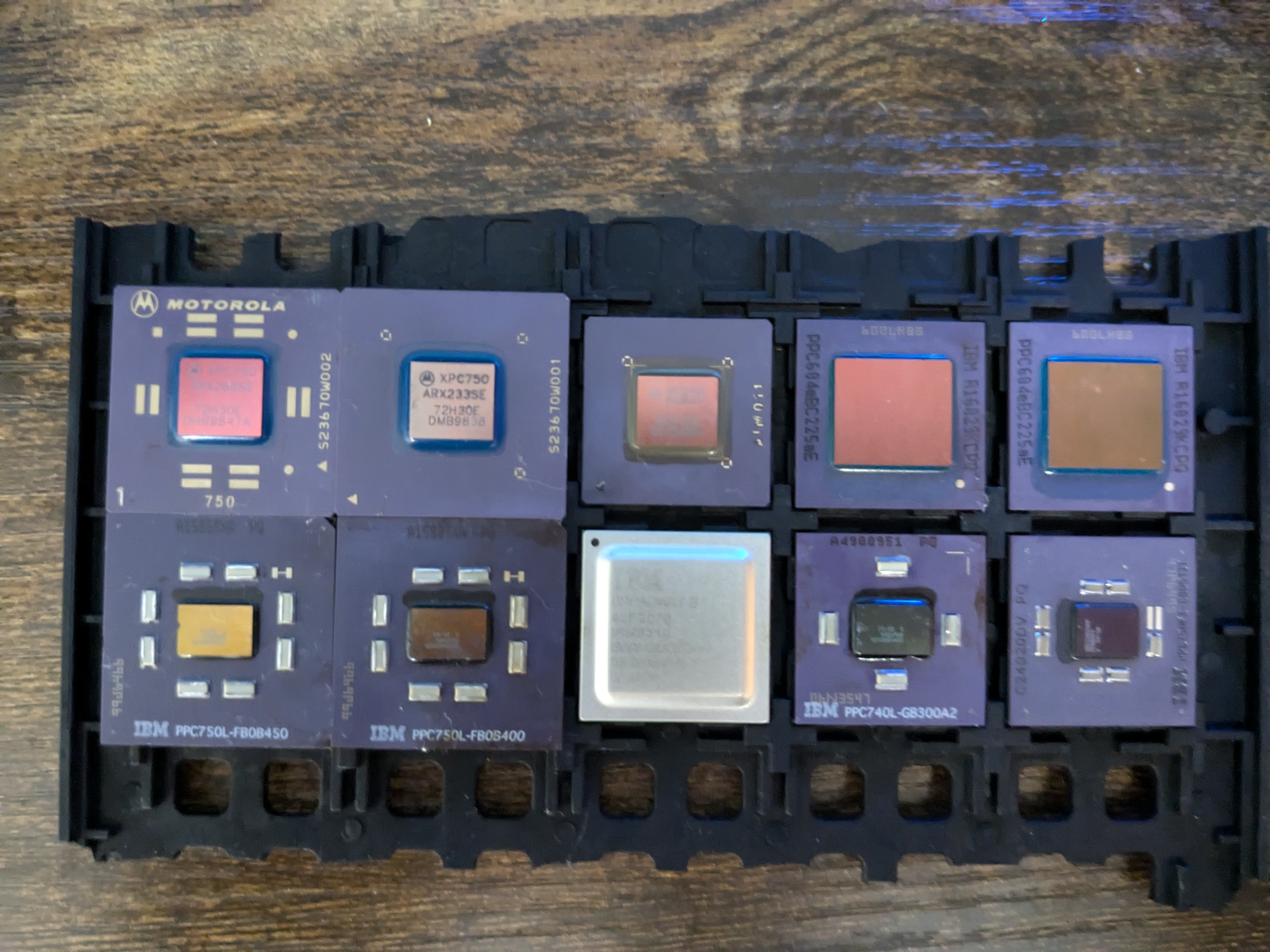

Talking of which, I did actually find an AliExpress store claiming to sell those MPC745s, though I failed to take notice of the low I/O voltages.
Means I won't be able to use it if it does show up, but a Plastic BGA G3 chip (instead of the usual Ceramic BGA) will still be a neat thing to have in my little chip collection :)
Here's a small selection of which:
