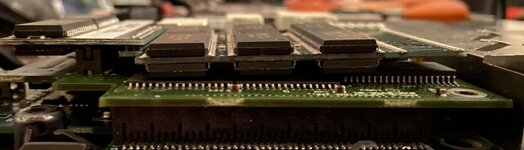

I picked up this weird frankenstein-eque 8MB RAM card for my spare PowerBook 180. I guess it was designed like that to gain clearance so they could put thick chips on the top side. It’s interesting and also quite janky. I’ll of course be bumping it to 10MB.
