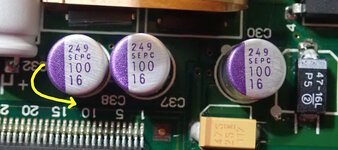

On revision 11, capacitor C38 is in the same orientation as C30 and C37. In revision 12, C38 is rotated 90 degrees. (Photo below is after recapping with aluminum polymer and tantalum capacitors.) By the way, most of the original capacitors have a much higher voltage rating than necessary. See the schematic to determine the actual voltage these capacitors are exposed to. For example, the 1 uF 50V capacitors were common. It doesn't mean that 50V ratings were necessary for the board; that was just the usual rating in that size package.
