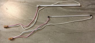

And these are the CCFLs for the Powerbook 140 (above) and 160 (below):
The 140 CCFL goes in the Sharp LM64P51 and the 160 goes in the Sharp LM64P58. The different sizes correspond to different voltages, hence the different inverter boards. I haven't measured the 140 CCFL as mine's working, but the 160's CCFL appears to be 160mm x 3mm in size.
