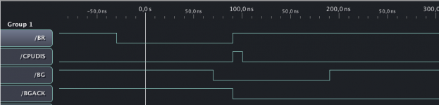

You could take a look at what the /BR, /BG and /BGACK signals are doing. I have the feeling it might not even reach the point where it even tries to take the bus from the 030.

Has anyone put a logic analyzer on CPUDIS in the Carrera/IIci config? My shiny nickel is on the Carrera juggling bus mastery with native 68030 directly at the CPU pinout level on the IIcx adapter. The Rocket appears to do the bus mastery shuffle over NuBus in the IIx, IIcx, IIci and even the PPC NuBus generation. RocketShare is supported on IIsi, but RocketWare in Accelerator mode is borked at that level.

Just picked my Carrera040 up at the customs office. Time to get the IIci out of the basement and hook the thing up to the LA to see what really is going on with bus takeover once the INIT loads.
Got a paper copy of the manual with it, do we have that already somewhere or should I scan it?
First thing sure should be to solder a few wires to your new 150 EUR toy...
At least we know now that it's doing it by the book:
This is when the INIT loads or everytime you pull the lever in the CP to one of the 040 options. It stays that way in normal operation. If you pull the lever to 030 in the control panel it just releases /BGACK and the 030 then kicks in again. Now over to the SE/30 to see if it even reaches that point...
