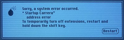

So I attempted the Carrera in an SE/30 this evening with the MicroMac PDS adapter.  I received identical results as Von.
All of the control panel versions (original unpatched, and both patched versions) opened just fine, but the controls had no affect on enabling the 040.  System remained at 16Mhz 68030 regardless of selector switch positions.
Placing the extension to the system folder and rebooting causes a bomb whilst loading extensions, regardless of which control panel is accompanied:
So, the extension will need serious attention.
