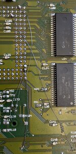

How sensitive is the memory bus, on these boards, to trace length? I’m starting to wonder if my bodge repairs to 4 of the data lines could be causing an issue.
Yes; I’m suspicious about the VRAM<->CLUT<->MEMCjr signals. I think I’ve ruled out most of the VRAM SIMM signals (two I need to double check) so I’m going to focus on the CLUT linkage next.
Can you supply a picture of the bodges?
Yup, here they are:
The bodged lines are DQ5, DQ4, DQ26 and DQ27 (I believe). I do now have some very fine enamel wire so I could try to repair the traces in-situ, this approach with the vias was just easier for me at my current skill level. :)
