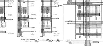

So I traced it out against the schematics. PDS slot pin C7 (RST_EXP) is supposed to run to a resistor — R74, which it does — and from there to a 74F00 quad NAND gate labeled U33.
506745248_1849716358924687_101626432683045304_n.jpg 507070203_4071769379774246_5416312106526767104_n.png
Which... was not there. There's a blob of adhesive there, but no component has ever been soldered on where U33 is supposed to be.

Not only was U33 missing, but so was U32 — supposed to be a 74F74 dual flip-flop — and the 0.1µF caps at C89 and C90.
The schematic appears to read "Do NOT stuff U32, U33, C91, C89 when using PrimeTime2". I would guess that these machines were meant to get an upgraded PrimeTime ASIC but didn't, hence the unpopulated U32 and U33. (I don't know what U33 is meant to do, and the machine is working fine without it. @Phipli suggested that U33 should not be populated and so far it doesn't seem necessary.)
