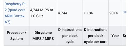

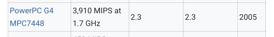

Can any useful emulation run on a Raspberry Pi Zero? CM4? CM5?
And that is the older Raspberry Pi 2. We don't play with old macs because of their compute power.
Nice! I won't have the cubic worries of doing a PowerBook PiPower resurrection for playtime. I can just leave the MDD LeafBlower unplugged!
