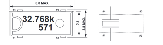

The oscillator is a KDS 2M 24.000, which I guess is a 24MHz oscillator - but it appears to have 4 pins. I haven't seen a 4 pin oscillator before, and I can't find the part online at all. What part can I replace it with? Any suggestions?
