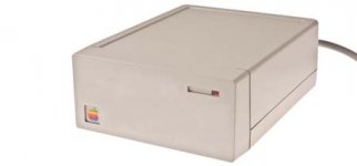

Problem: On a stock Apple IIe the Profile is far too wide to sit on top of the case and doesn't match with the computer or monitor. The only real device that nicely fits under the monitor is the Duodisk drive.
Solution: The AppleFile.
What it is: It's a DuoDisk drive with the internals removed and the front filled in with Bondo and textured with a sponge while the filler is still soft. An LED is recycled and placed above the Apple logo to act as an Indicator when the drive is busy.
Internally there will be space for one half height 5.25" SCSI disk (in my case a Seagate ST-225N for authentic drive capacity and sounds :o) ) and a small 5V/12V power supply.
On the rear there will be the power switch, a standard IEC computer power cable socket and a centronics 50 pin SCSI connector to allow the use of Apple's own SCSI cable.
Using the Sandwich II SCSI card it is a ProDOS bootable volume.
OPTION: Make SCSI interface on back of AppleFile passive so you can daisy chain in more SCSI devices.
Challenges:
-Get the bondo textured to match the rest of the drive
-find paint that best matches the platinum color of the drive to paint over Bondo
Time to Completion: Pending. Just moved and currently sourcing components.

Wow, that UniDisk looks like it would be perfect for a 3.5" drive to be nudged inside though adding the PSU might take a bit of work. I guess because you will be dealing with a smaller drive and this a lighter power load you can take one of those 5v/12v wallwarts, gut it and mount it inside and again have the power switch and plug on the back. I kinda did the same when I installed a hard drive inside a TRS-80 Model II.
I'd actually recommend that hack first because Unidisks grow on trees compared to DuoDisks.
I did some glance measurements and you would have to mount a half height 5.25" hard drive sideways in the DuoDisk as the case is only deep enough to fit floppy drives and not hard drives. It might still work. I'll double check on this.
What would be even cooler is to setup a smartport HD in there along with a 5.25 drive --- and leave one of the slots open. There's plenty of room for that, and the microcontroller/flash drive is perfect for just sitting along on the bus with floppy drives. It wouldn't be as fast as SCSI, but it also wouldn't require a SCSI card either
I'd say put the USB connector around back then. It would look totaly anachronistic to have it anywhere on the front.
The donor enclosure has arrived.
Not sure if I should wait for things to warm up before I start applying the bondo. It's pretty cold outside.
If you get a small stick of modeling clay, you could press it against the plastic to get just the right texture. Then after the bondo hardens a bit, you could gently press the clay on the bondo so the texture perfectly matches the rest of the case.
Bondo day. No turning back now. xx(
You can't really texture it until you put the paint on. The sanding of the bondo completely takes it off.
I'm considering going to a paint shop with a digital color matching system and seeing if I can get a small can mixed up. Then I can either try brushing it on or mix in thinner and use an air brush.
Looking at the back I realize I can't easily install a regular 50 pin SCSI connector without making a mess so I'll just have a regular DB25 connector on the outside that breaks to the usual SCSI ribbon cable inside.
Those things aren't particularly rare, and the functionality they have is super easily duplicated by just using two unidisks anyway.
I guess one has to see the finished product to make a decision.
But i believe they are kind off rare over here in europe.
