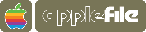

I'm working on some product packaging with some vintage logos on it. I just happened to have the font. Specifically, it's Motter Tektura Cyrillic. It's a little more bold than the normal Motter Tektura.
Apple's was still custom, though, because it had a few custom characters (the S, ], [, and / are different.) I had to make a new S.
Excellent.
Motter Tektura Cyrillic wouldn't happen to be available online from a reputable source would it?
The ProFile's badge looks like olePigeon's rendering. So if you'd like it to be in line with the rest of Apple's products, I'd go with that.
Yeah, I bought the files to help square it out. It's still a little ragged but form the photos it's now hard to notice.
I noticed that after looking at a few of the fonts and realized "say! these arenn't the same!" Thanks for noting the Cyrillic part. Thanks for the awesome custom badge. I guess at the very least now I can have a small custom sticker made but it won't feel the same as a proper stamped aluminum badge but that's for someone else to try if they would like to make their own Applefile. I like the Apple-only front. ;)
to make your searching safer, I grabbed it here.
Wouldn't look right. If you look at Apple peripherals of the time, if it had rounded edges (ProFile, Unifile, and the Apple III) it had the apple logo and our badge on the left side.
Around the time of the IIe it changed. If you look at the IIe platinum or either the monochrome or color monitors the apple logo is on the right and if you look at the DuoDisk you had that groove and everything had nice hard edges. If anything my lack of a platinum IIe breaks the uniformity on my end but I think the badge would even more break the theme going on with the peripherals where there's no badges at all except the apple logo on the right.
Yeah I wouldn't put anything on the front. It matches the stack perfectly as is. The text of that logo should go on the back where the duodisk text is if you we're going to put it on the physical device at all.
There's probably a way to print on an aluminum plate, but I bet it'd be the most expensive part of the whole build.
