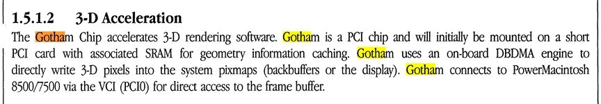

The mention of "Gotham" in 1993 for the 3D-subsystem is very interesting and new to me since i thought that "White Magic" was the older name for the project. I still suspect that Gotham was originally planned as a 40MHz PPC-PDS add-on, maybe with a direct path to the VRAM on a PPC-PDS-graphics card.
The 1992 3D implementation was separated into 2 chips per render-pipeline: The Z-chip and the RGB-chip. Other patents mention a comand-decoder chip as well. The 1995 "Gotham" has a PCI-interface and the rasterizer chip. I am still interested to know what the PCI-bridge/interface chip actually does. Is it only a simple PCI-bridge or is there something more inside?
I think that Gotham was nearly final in 1994, including the texture unit. Internal testing with the early tape-out chips would have started in 1994. In late 1994 to early 1995, the "White Magic" developer card would have been ready. The white magic cards would have been sent to developers between February 95 and June 95.
Gotham will perform DMA writes to VRAM of approximately 50 megabytes / second,
DMA reads of system DRAM of approximately 10 to 20 megabytes / second,
and DMA writes of system DRAM of 4 megabytes / second.
This would explain the fact that the speed does not scale very well beyond the simultaneous usage of 3 cards.
54MB/s writes + 10-20MB/s reads on the PCI bus. => 64-74MB/s bandwidth per card. If the VRAM writes could be separated from the PCI-bus, the performance-potential would be much better.
The Gotham ERS is even dated 1992!
The article I attached talks about a 40MHz 040 with a DSP and hardware rasterizer in a PDS slot. It can't be the 840av I thought it was, so it must be a 40MHz Q650 or Q800 based machine. I'm guessing it has the Q840's DSP on the same card as the Rasterizer... They were using the DSP for... Accelerating "transformation, clipping and shading". Do I remember the PPC has some DSP hardware built in, or was that marketing nonsense excusing the loss of the DSP between the 840 and the 8100?
The best thing to do would be investigate the PCI implementation on the 7200 and 7500. It is very likely to be related, although they baked it in with other functions. Note that the 7200 is the only PCI Mac with Apple designed hardware quickdraw acceleration... Worth noting. Frustratingly it isn't compatible with Virtual Memory, so that might have put them off.
They mention using another connection directly between the cards and VRAM to speed up transfers. Obviously we never got that.
