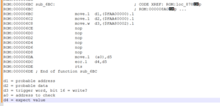

Took a moment to dig into this earlier today after seeing one of these on ebay. This card may be found under the P/Ns 820-0199-C, 077-8264, probably others. It is a component of the AppleCAT test kit. Specifically, it is used to test that Nubus bus mastering works correctly.
The card itself appears to be extremely simple, with some registers to store a 32 bit address and data along with PALs to work the nubus. The bus master card must be installed in slot $A (Second nubus slot) per the documentation (found here). The DeclROM contains no code, just a basic ROM to announce "I am here" to slot manager and nothing else (as expected).
Theory of operation: AppleCAT is an early version of the Techstep, it sends payloads over serial (Found as KODE resources in the AppleCAT binary) to the system under test which executes them and indicates success/fail. The magic bit of code here is sub_6BC; it writes an longword address to a register of the card in Slot $A, along longword of data, then sends a trigger to a third address. Looks to me like that trigger can have bit 8 set to cause a write, otherwise it performs a read. The routine waits a bit (nops) during which the card i assumed to be doing its thing, then checks a provided address against an expected value to verify the requested operation was performed using bus mastering. The routine loc_8D8 sets up both a read and a write test using that routine.
Long story short, all the bus master card is used for is to (upon a deliberate trigger) perform a data read from an address into its register, or to write data from its register to that address. It otherwise does nothing but look cool. TLDR: It's a diagnostic card, nothing more, doesn't enable any interesting functionality nor does it accelerate the machine in any way.
Attached is a quick IDA disassembly, a copy of the ROM, a fixed floppy image, and some other bits relevant.
